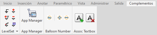

Hi, I have been using GeorefImg for a long time and I find it a very useful tool. Since a couple of versions ago, the panel with the icons in the Autocad plugins group has disappeared and I have not been able to show it again; the only thing I managed to do was to add a menu with an icon in the Autocad menu bar, but nothing else. I have tried to uninstall the add-in and reload it, but nothing has changed, the panel still does not appear. This is how it appears at the moment: Does anyone know how to get the GeorefImg panel to appear? Thanks.

Hello, are you using the version from Autodesk Apps or the manual install here from the Download page? The Apps installer should install the CUIx menu automatically. In any case, you should be able to CUILOAD the .cuix file manually (a one-time operation only).

Hello, thank you for the quick response. I have used both methods to install the add-in and both failed to display the tab in the Autocad add-ins ribbon. What I have done is to go into the UI customization options and unloaded the GeoreImg panel and click "apply", then reloaded it in the same options dialog, click again "apply" and the panel is now showing in the add-ins. Thank you very much for the advice
