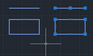

AutoCAD (DWG) internally calculates with numbers stored as 64-bit double-precision data, which allow to interpret and display numbers with cca 15 digits (places). But if you locate your DWG drawing to very large coordinates, you spend this numerical capacity to represent mostly static parts of the coordinate values - e.g. a geodetic coordinate system starting at 1000000 units will consume about 6-7 digits of the total 15 digits to express just the more or less "static" value of meters or feets (left to decimal point) and only 8 digits will remain for the decimal value for computing precision. This will result to inaccurate calculations in more demanding geometric computational problems.
This inaccuracy can then manifest itself in various ways - no touch point of spline curves found, inaccurate intersection points, curve offsets, shifted osnap points, tracking, etc. It can also manifest itself in more unusual phenomena such as not finding a fill boundary for hatches or displaying short lines with a single grip only. The more demanding geometrical transformation is performed (e.g. in Civil 3D) and the more distant are the coordinates from [0,0,0], the more significant can be the inaccuracies.
A similar problem can arise when moving objects too far in the Z-axis. Compare the grips on the objects on the left (moved to Z=9.9E+12) and on the right (same objects, Z=0):
So we recommend in case of such problems to move (_MOVE) temporarily the content of your DWG drawing as close as possible to the absolute global origin (0 0). After you complete the calculation, you can move the content back. A mere change of the UCS will not help as the calculations are internally performed in the global coordinate system (GCS).
