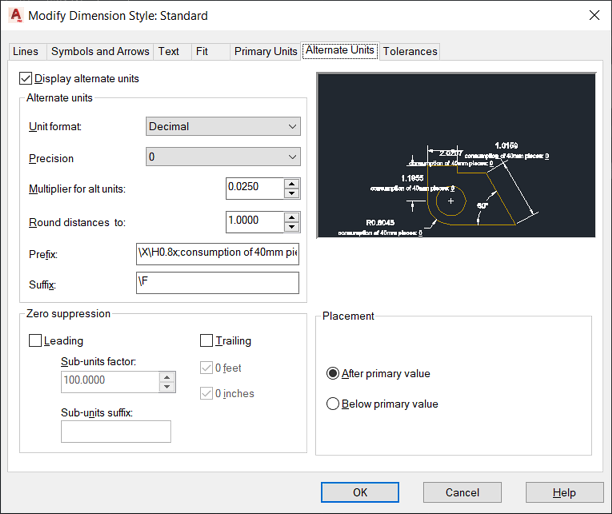

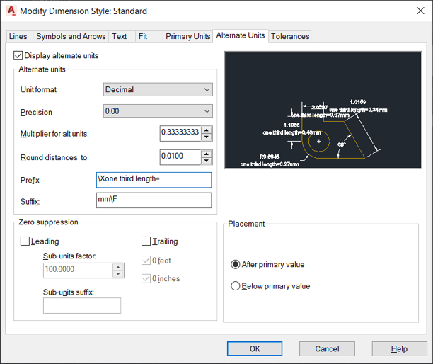

On the Primary Units tab, set the Suffix to "\F" or " mm\F". Why "\F"? That's one of the control codes for formatting text (see the Tip 8640) - it switches the font of the text, and effectively tells AutoCAD to "consider the following text as the font name" - thus "turning off" the automatically inserted "[" (until a semicolon or other control code is found).
The further required settings will depend on your desired "calculation" of the alternative dimension data. For example, if you want to display one-third of the measured dimension length, set the "Alternative units multiplier" to 0.333333 and then the desired Precision and Rounding. Set the desired prefix (the code "\X" means: wrap below the dimension line) and use "\F" again at the end of the suffix to turn off the automatically inserted closing square bracket ("]").
Or, if you want to calculate the estimated consumption of pieces of panels, pipes, fence posts, etc. per dimensioned length, use a calculation with a factor that determines the relationship between the length of the geometry and the length of the part - for example, for 40mm parts, the multiplier would be 0.025 (1/40). Again, set the Precision and Rounding - in this case, probably "0" and "1". You can also use other control characters in the Prefix and Suffix fields, e.g. "\H" for text height or "\L" for underline.
